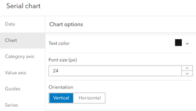

@LJackson29 Serial charts allow you to control the size/color of labels on the Chart tab during configuration. Further refinement (e.g. change size) can be done on the Category Axis and Value Axis. Is there something else you need? Also, can you provide more info on "just show the number and not the category label"? (depending on the answer, we might have to consider that as a separate idea/request)

The size of the labels on the bars/columns on a serial chart is controlled by the Font Size setting on the Chart tab.
