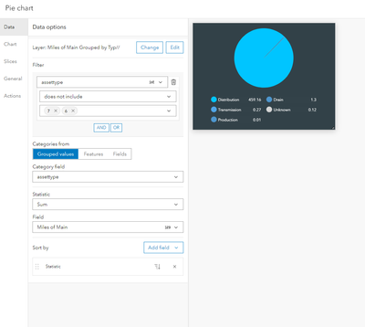

Here is the code I used to get it done.  I am very new to this so I made notes in terms that I understand as of now.  Hopefully it helps others.
// GIS portal url from navigating to portal through browser
var portal = Portal('https://www.youraddress.arcgis.com/');
var fs = FeatureSetByPortalItem(
// Hosted feature layer id from navigating to it through browser web address
    portal, 'xxxxxxxxxxxxxxx',
// layerID if sublayers are used also from web address
    xxxxxx,
// Field names of attributes you want returned for use
    ['Shape__Length','assettype'],
    false
// Miles of main converted from feet grouped by main type
var fs_gp = GroupBy(fs, ['assettype'], [{name: 'Miles of Main', expression: 'Shape__Length*0.000189394', statistic: 'SUM' }]);
return fs_gp

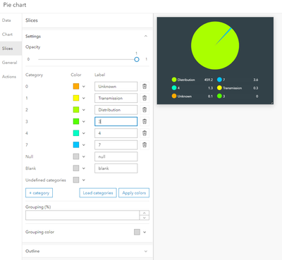

Data available in chart after codeData available in chart after codeHaving to re-label because I couldn't figure out how to get the domain namesHaving to re-label because I couldn't figure out how to get the domain names
