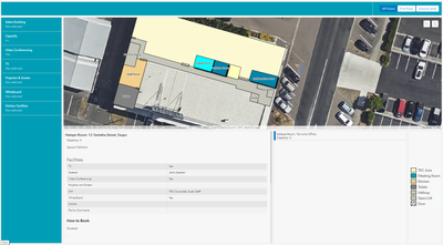

I've just come looking for this same function!
However also the ability to share based on a feature selected or shown in a widget or the filtering conditions.
In my case I'm using dashboards as the app for our meeting room finder (tried in Experience Builder but the filtering widget doesn't quite have the capability I need).
Once someone has selected the meeting room of interest, it would be useful to have a URL that could be added to a calendar appointment that would open up the dashboard to that location.
Another scenario could be sending a URL with a list of appropriate rooms based on the filtering.
