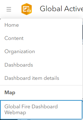

Open the saved copy of the dashboard editing, and use the navigation menu in the upper left to find a link to the map(s).
Open the maps and save copies. You should be able to add your layers to your saved copies.
