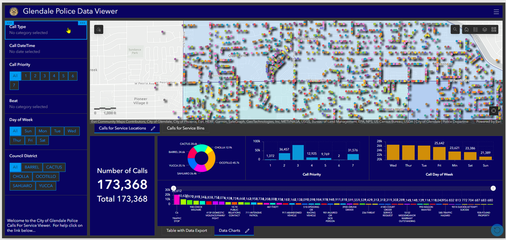

My dashboard(s) is setup where nearly every widget, category chart has an "Action" tied back to the map feature.  So after someone has configured all the categories, table filters, etc. (e.g. screen capture 2 below0  They then want to review the filtered sub-set (screen capture 2) by clicking on filtered points on the map.  Now when they click on one of the sub-set points to get more info about the point the entire dashboard filters to 1 point and the user has lost all their settings/applied-filters, etc..

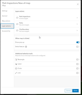

 In many cases it is not an improvement to select a feature with a click because the user just want to show a popup without filtering. The old workflow was the right one. Please, restore it at least as an option! Let define in the configuration if the select tool is active by default or if (as before the update) the user must activate it.

THANK YOU Esri for fixing this "enhancement" in the latest release!!  Making these optional is great

Fixed with the October 2023 Update! Thank you, Esri!

THANK YOU so much for making this optional. My Dashboard is about to go live and I was panicking!
