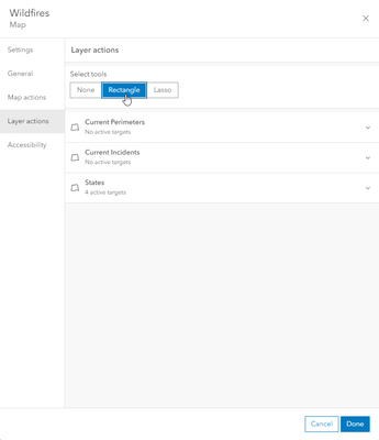

There is no longer a need to activate a selection tool or to choose a layer when features from more than one layer are selected. The new click-it-to-select-it behavior is automatically enabled when layer actions are configured. If you prefer giving your users the choice to select multiple features within a certain area, you have the option to add a rectangle or lasso selection tool to your map. Once the dashboard viewer activates the tool, the click and drag motion that usually pans the map is repurposed to draw a rectangle or lasso for selection.
Enable the option to select by rectangle or lassoEnable the option to select by rectangle or lassoDashboards created before the June 2023 update of ArcGIS Dashboards will have the rectangle selection tool visible when layer actions are present.
