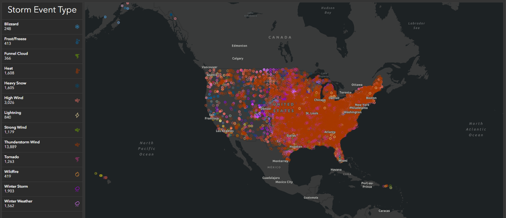

What we really want is something like this.
 The unique list we've been dreaming of.The unique list we've been dreaming of.
Our different event types are nicely grouped so the list is unique, we even have a count of the number of events each type has. Filtering from the list displays all features with that event type.

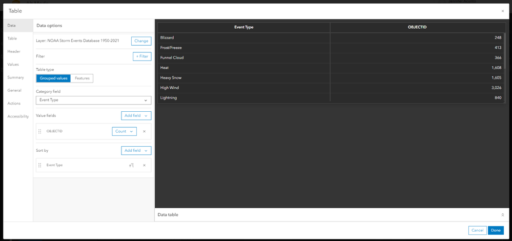

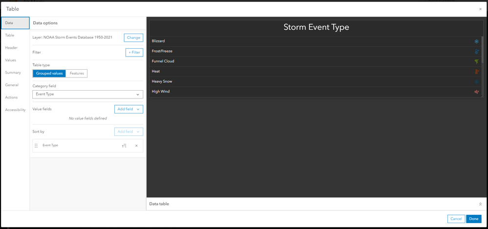

I created a table and used the Grouped values type and selected my event types as the category field. Next, I added a value field that counts the ObjectIDs so I can determine how many features I have in each event type.
Table Data TabTable Data Tab
 Note: If you only want to display the unique list of categories, you don't have to add a value field.
 Categories OnlyCategories Only
It’s important to note that you only have access to the attributes that you add on the Data tab. This dataset has all sorts of fields, but only the two I specifically added are available to me.
Limited Fields AvailableLimited Fields Available

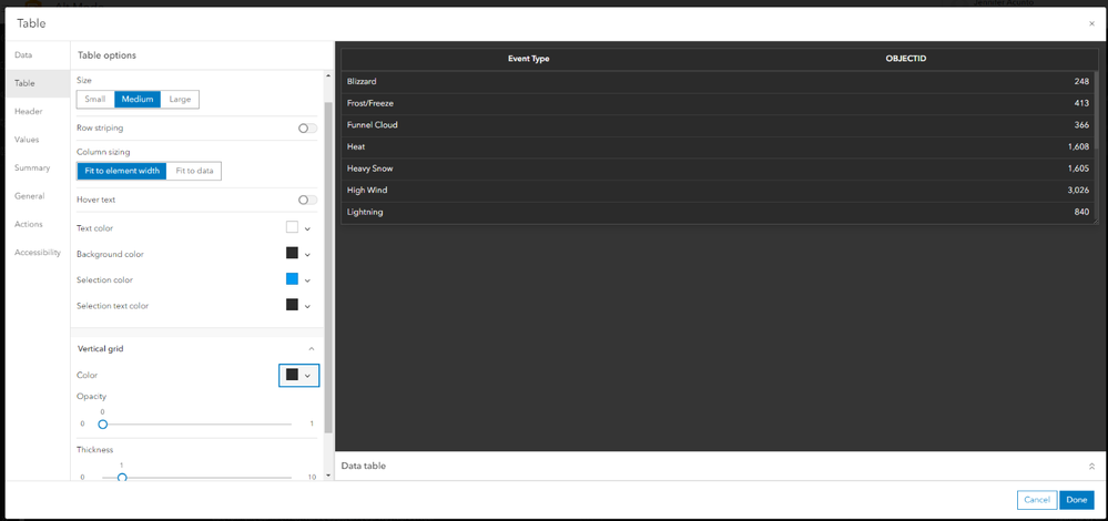

On the Table tab, I changed the vertical grid color to match the background color.
Table TabTable Tab

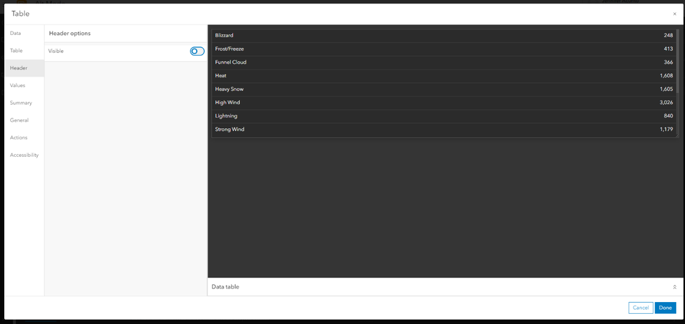

Moving to the Header tab, I turned off the headers.
Header TabHeader Tab

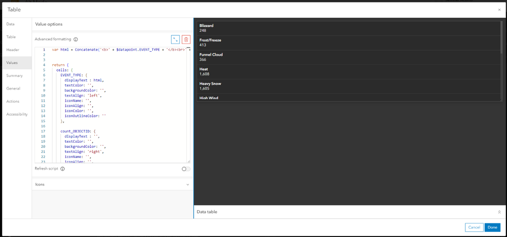

The real magic is taking place in the Values tab, where I am using Advanced Formatting and Arcade to make my table look less table like.

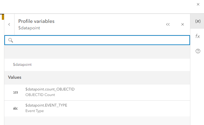

I didn’t want my event counts to be in their own column, so I used Arcade to return some HTML that bolds my event type and adds the event count on a new line.
var html = Concatenate('<b>' + $datapoint.EVENT_TYPE + '</b><br>' + Text($datapoint.count_OBJECTID, '###,###'))
Then I returned the HTML as the display text for my Event Type column and changed the ObjectID column display text to empty quotes.
Advanced FormattingAdvanced Formatting

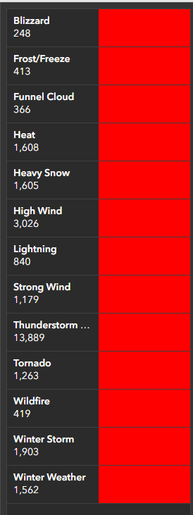

My ObjectID column still exists and takes up space. If I make that column have a red background you can get a better idea of what I’m talking about.
Ghost ColumnGhost Column
I could set my table to ‘Fit to data’ and then resize my element so that that column barely shows, but I risk having a random horizontal scroll bar show up at the bottom. With so many different screen sizes it’s hard to size it right where you won’t get the scroll bar but also don’t have a lot of empty space.

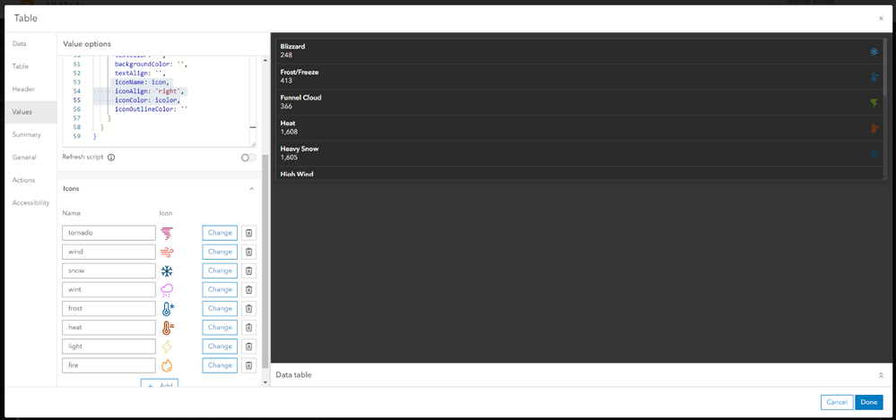

I decided that if I have to have that column, then i will simply repurpose it.
I added some custom icons and used Arcade to dynamically display the icon and color.
Arcade + Custom IconsArcade + Custom Icons
Note, dashboard will override the icon color, so if you don’t specify it in the return statement, they will be the default color, even if the actual icon you added has color.
JenniferAcunto_7-1712243837688.pngDefault Icon Color

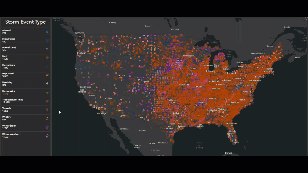

The final step was to add a nice title on the General tab and voilà my unique list is done.
Finished DashboardFinished Dashboard
