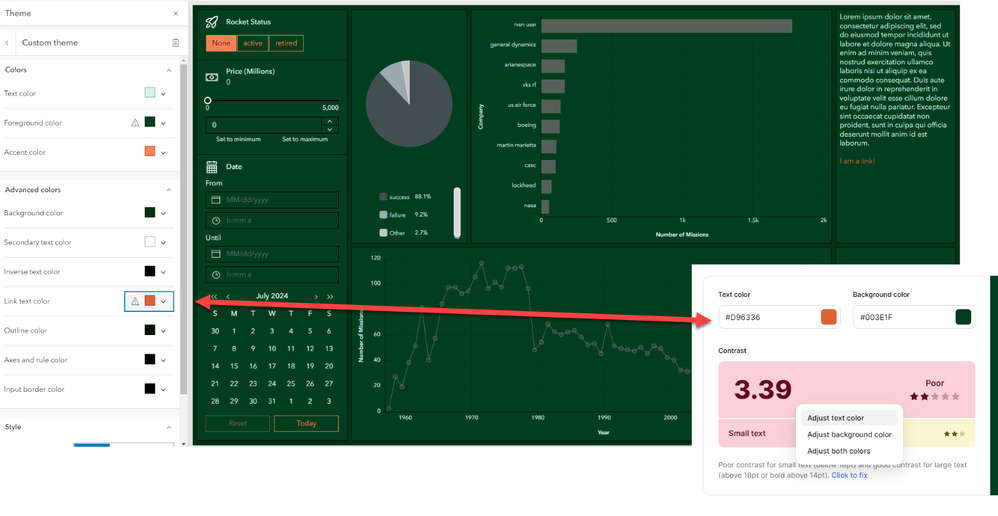

I quickly learned that quite a lot of these colors affect text colors, so ensuring I have enough contrast between color choices is going to be a priority when selecting my color palette. Dashboards will warn you if there is not enough contrast between important colors, but I like to check all my colors in Coolors.co. Not only does it check the contrast, but it also recommends replacement colors when your choices don’t meet accessibility guidelines.

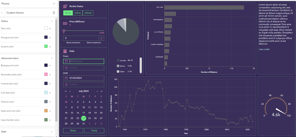

I recommend starting out by picking your Foreground color, as this will be the color that most of your text will be on.
For this example, I will use: #392F5A
Next, I will pick my colors that must be high contrast compared to the Foreground color:
  • Accent color: #6EEB83
  • Text color: #FFFFFF
  • Link Text color: #CAF0F8
  • Secondary Text color: #FF99C9
Next on the list is the Inverse Text color. This is used as a text color on top of our Accent color, so I will need to make sure there is sufficient contrast between the two.
  • Inverse Text color: #392F5A
The Axes and Rule color affects only the grid lines of our charts and gauges, so I can relax a bit on my contrast requirements if I want.
  • Axes and Rule color: # E6AA68
That just leaves my Outline and Input Border colors. These are purely decorative, so contrast isn’t a huge concern here.
  • Outline color: #738290
  • Input Border color: #73956F
Here’s the resulting space-themed dashboard.

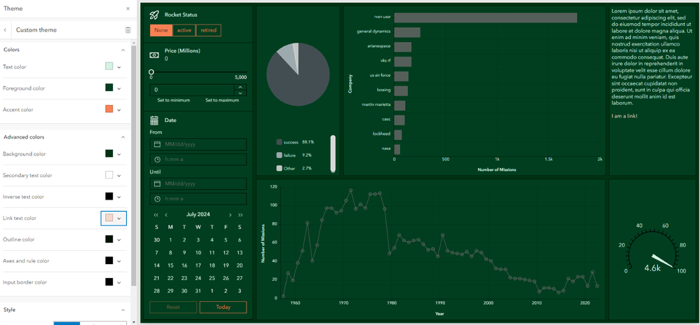

You may have noticed that there are two color sections in the Theme sidebar. One is Colors and the other is Advanced Colors.
Dashboard will provide Advanced Color suggestions based on the colors you choose in the top section.

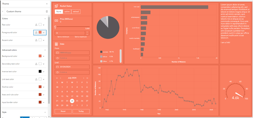

Selecting a Foreground color will change the Background, Outline, Axes and Rules, and Input Border colors.
Orange to highlight the changes only, please don't do this in real life.Orange to highlight the changes only, please don't do this in real life.

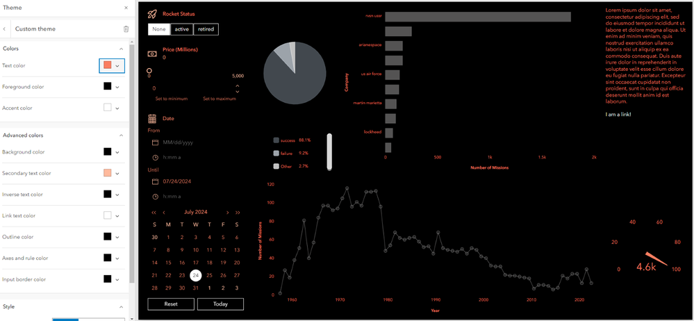

Selecting a Text color will also change the Secondary Text color.
Text Color ChangesText Color Changes

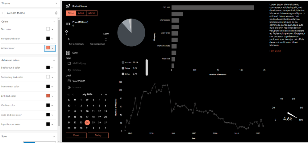

Selecting an Accent color changes the Link color.
Accent Color ChangesAccent Color Changes

I could also set the top 3 colors and stick with the suggestions in the Advanced Colors section. For suggested colors that don’t meet accessibility standards, I can use Coolors.co to suggest a new color.
 Tweaking the suggested colorsTweaking the suggested colors
Accessible colorsAccessible colors

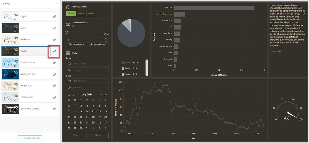

You can also get a head start on your theme creation by copying one of the built-in themes and making a couple of tweaks. Find a theme you like, and then hit the copy icon on the right.
Copy themeCopy theme

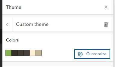

This copies the theme into the Custom Theme editor hit the Customize button to start making changes.
Customize themeCustomize theme
Now I can swap out that green for a pink.
Built-in theme customizedBuilt-in theme customized
