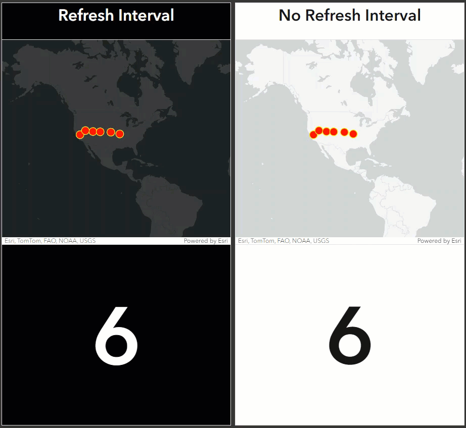

Here I have a dashboard with the same layer used in 2 different maps and indicators, one set with a refresh interval set, and one without. Let’s see what happens when I add a new point.
 Dashboard elements with and without a refresh interval.Dashboard elements with and without a refresh interval.

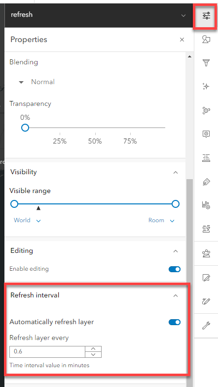

Select the layer in your webmap and open the Properties pane.
Toggle on the refresh interval and set a value (in minutes).
  • .5 = 30 seconds
  • 1 = 1 minute
  • 60 = 1 hour
  • 1440 = 1 day
Properties > Refresh intervalProperties > Refresh interval
The layer has a maximum cache age of .5, so I’ve set the refresh interval slightly above (.6) that age.

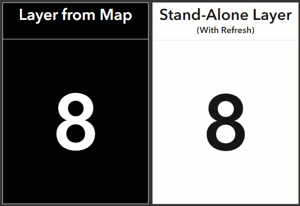

In ArcGIS Dashboard, you can bring in data layers from the map or as stand-alone layers. If you set a refresh interval in the map, it will ONLY be applied to widgets in the dashboard that are using the layer from that specific map. This is an important distinction that I see folks get confused with.
One layer. Two different dashboard sources.One layer. Two different dashboard sources.
Here are two different indicators using the same data layer. One is coming from a map with a refresh interval, the other is added as a stand-alone layer.
Same layer. Different refresh settings.Same layer. Different refresh settings.

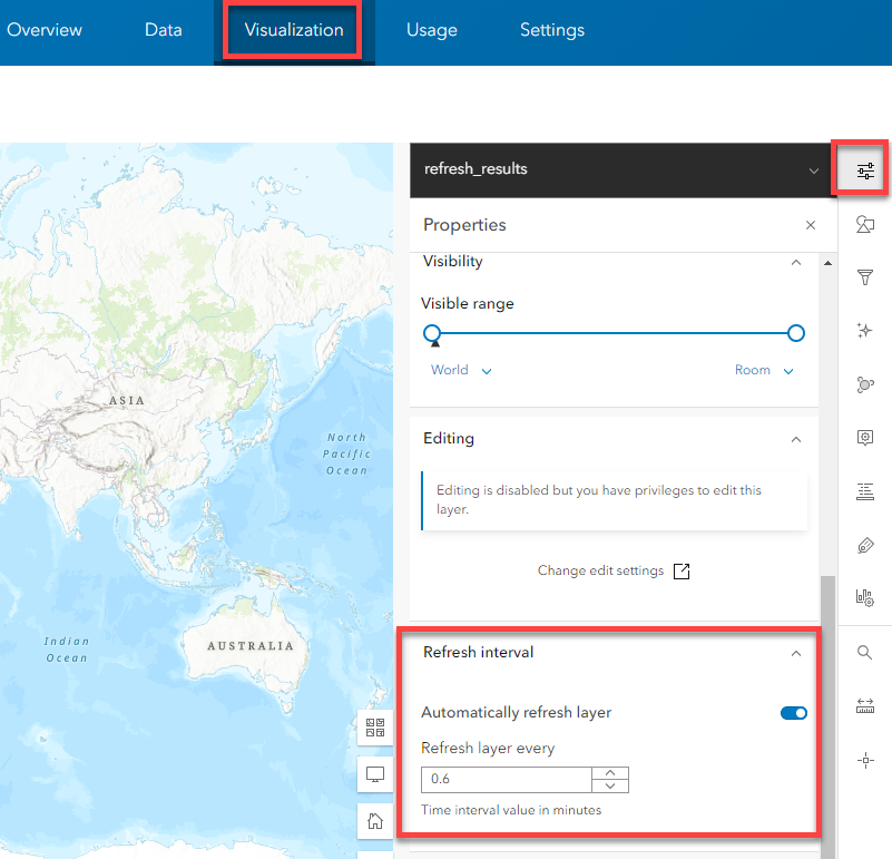

Navigate to your layer’s Item Details page.
Go to the Visualization tab.
Ensure the layer is selected and open the Properties pane.
Save.
Visualization > Properties > Refresh intervalVisualization > Properties > Refresh interval
The nice thing about setting it here at the layer level is that every time someone uses this layer, that refresh interval is already set. I can bring this layer into my dashboard as a stand-alone layer and have it automatically refresh.
The downside is that you can only set this for layers you own or have permission to update.
Adding a refresh interval to our stand-alone layer.Adding a refresh interval to our stand-alone layer.

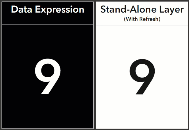

So what happens if you use a layer with a refresh interval in a data expression? Does that refresh interval trickle down?
Data expression using a layer with a refresh interval.Data expression using a layer with a refresh interval.

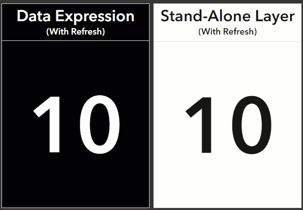

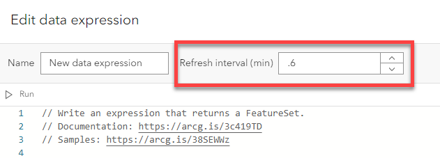

It does not. You will need to set the refresh interval in your data expression as well.
In the Data Expression Arcade editor, there is a refresh interval located next to the name box.
Data Expression Refresh IntervalData Expression Refresh Interval
Data expression with refresh interval.Data expression with refresh interval.
