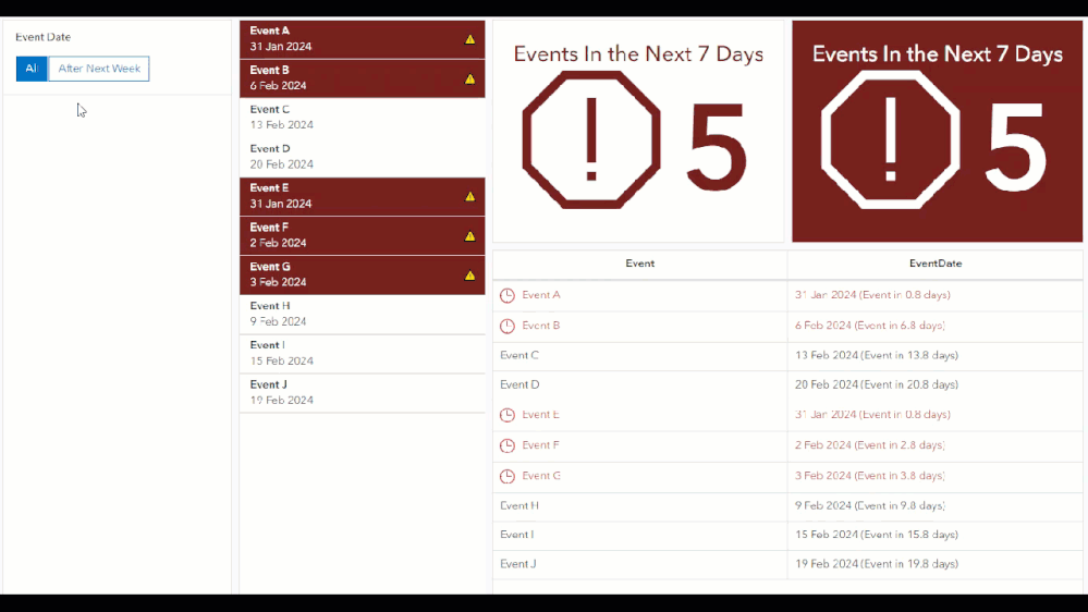

Here I have a basic dashboard showing events and their event dates. There are all sorts of changes happening based on if an event date is occurring within the next 7 days or not. I wouldn’t incorporate all of these different formatting options on a single dashboard, but I wanted to show you all a buffet of options you can play with. I also added a filter so you can see what the indicators look like when there are not any events occurring within the next 7 days.
 Highlighting Approaching DatesHighlighting Approaching Dates

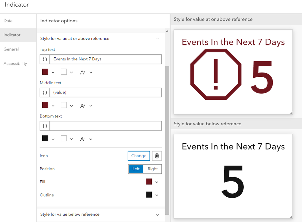

Moving on to the Indicator tab, I removed the {reference} value from the bottom row and toggled on Conditional Formatting.
Conditional FormattingConditional Formatting
Now I can individually style the text, text color, icons, and icon color for values at and above my reference value (which was 1).
Setting up both indicator apperances.Setting up both indicator apperances.

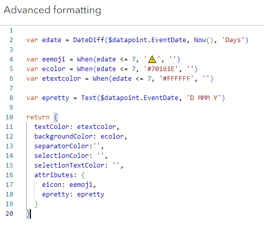

First, I used Arcade to determine how many days there are between Now and the Event Date.
var edate = DateDiff($datapoint.EventDate, Now(), 'Days')
Now that I have the number of days between those two points of time, I can use that value in a simple When statement to do all sorts of things. The statement basically says...
When the days between now and the event are equal to or less than 7, provide me something, if not provide me something else.
What makes this useful is that something provided can be a color, text, icon name, or emoji.
var eemoji = When(edate <= 7, ':warning:', '')
var ecolor = When(edate <= 7, '#70161E', '')
var etextcolor = When(edate <= 7, '#FFFFFF', '')
Next, I plugged in my new variables into the return statement.
 List ArcadeList Arcade
Table ArcadeTable Arcade

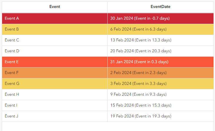

What if you want to set up multiple time periods to alert on? Easy, you just need to expand your When statement.
 Multiple Date 'Alerts'Multiple Date 'Alerts'
I have different colors displaying based on when the event occurs:
  • Event Date has passed: Red
  • Event is today: Bright Orange
  • Event is less than 3 days away: Light Orange
  • Event is over 3 days away but less than 7: Yellow
var ecolor = When(edate < 0, '#CC2836',
              edate >= 0 && edate < 1, '#F95738',
              edate >= 1 && edate < 3, '#EE964B',
              edate >= 3 && edate <= 7, '#F4D35E','')
