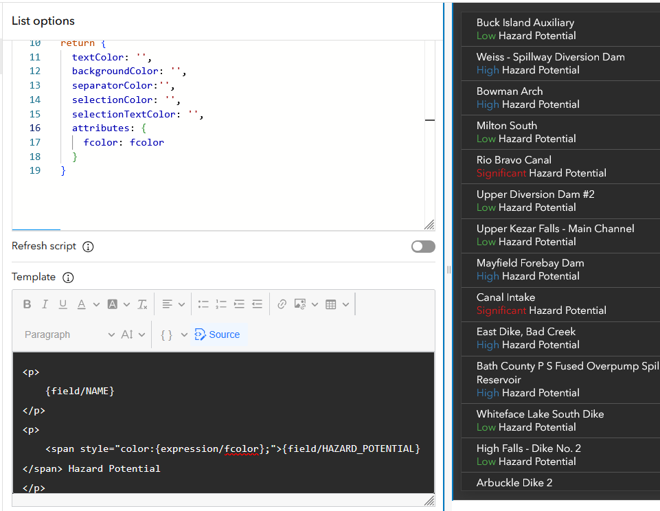

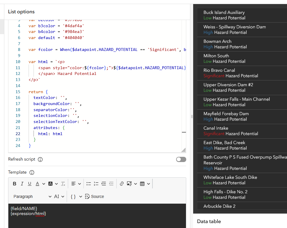

While you can add your HTML to the template field and then reference a returned Arcade value within that HTML, it is so much easier to have the Arcade return the HTML. This keeps everything in one place (the advanced formatting section) as opposed to split up between the template and advanced formatting sections.
Inevitably, you will find yourself having to make updates after not looking at it for 6+ months. Not only will it be easier to make updates in one place, but it will be much easier for you to figure out what exactly you were doing in the first place. Nobody (including future you) wants to jump between reading code in two separate areas to determine what that code is doing.
