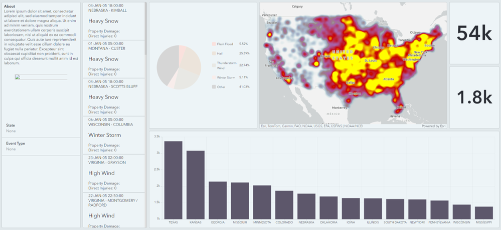

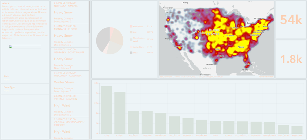

What would you think if you were presented with this dashboard? Would you know what is going on? Would you understand the data being presented? Would you even bother trying to understand it or would you just move on?
Dashboard so hard to read it is practically useless.Dashboard so hard to read it is practically useless.
It is hard to read, hard to tell which colors are what in the pie chart, and there’s no indication of what those indicators and image are. Most users (rightfully) would not even try to use this.
If you aren’t using Accessibility best practices when designing your dashboards, then your dashboards could look/act very similar to this one for some of your users. Let’s look at how we can make this dashboard clearer for everyone.

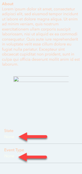

The higher the contrast between background and foreground colors, the easier it is to distinguish between the two. This is especially important for text. My sample dashboard is so hard to read because there is poor contrast between the font color and the background color. To those of you thinking, “It’s not that bad. I can still read it.”, did you even notice the filter text?
Poor contrast makes this sidebar element so hard to read.Poor contrast makes this sidebar element so hard to read.

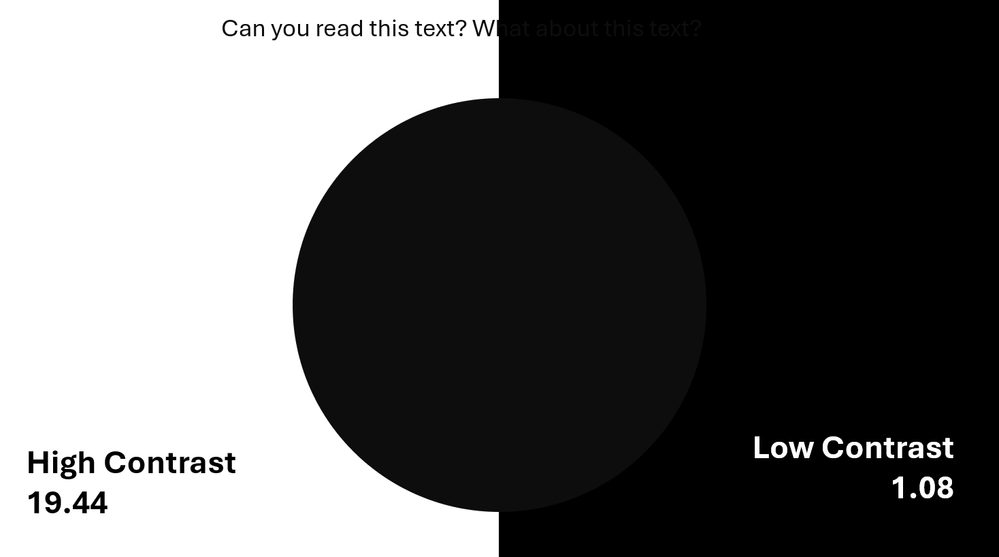

What may be enough contrast for you, might not be enough contrast for others. So instead of simply eye-balling it, you should use contrast checkers to determine exactly how much contrast there is between colors. At a minimum, your contrast should be 4.5 or higher.
High and low contrast shape and text.High and low contrast shape and text.
The smaller the object, the more sensitive it is to contrast. While you may still be able to see the large circle on both sides, how well can you read the same colored text at the top?

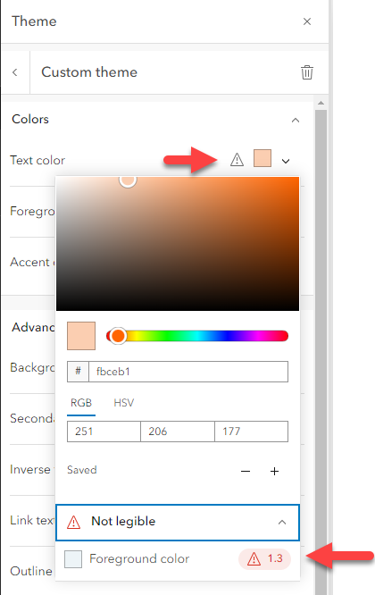

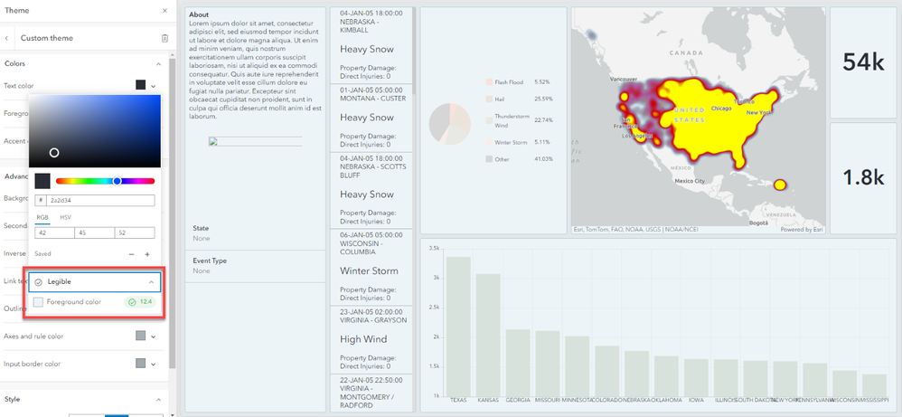

With the introduction of Themes, Dashboard now alerts you when you do not have enough contrast between your theme colors and provides you with the contrast score.
Insufficient contrast warningInsufficient contrast warning
So, I'll change our text color to something more accessible.
Dashboard with high contrast between text and background color.Dashboard with high contrast between text and background color.

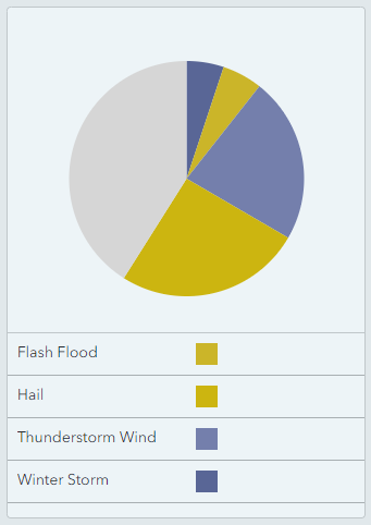

What about this chart? Is it easier to understand?
Pie chart with distinct color scheme.Pie chart with distinct color scheme.
While this might be clearer for you, for folks with protanopia, a type of color blindness, this chart looks exactly like the first one. Once again, you can’t simply trust that just because it looks clear to you that your dashboard will be clear to your users.

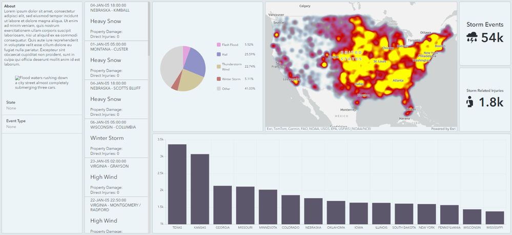

When color is important, be sure you are using color blind friendly color palettes. I’ll go ahead and adjust the pie chart to something with more distinct, color-blind friendly colors.
Dashboard with updated pie chart symbologyDashboard with updated pie chart symbology

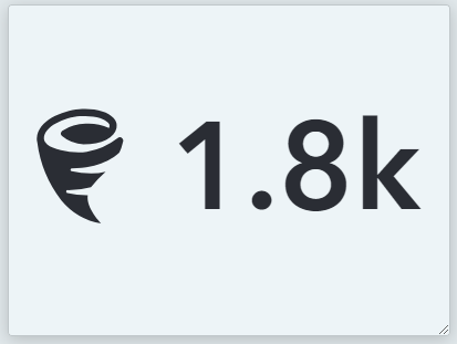

Icons can be added to a variety of dashboard elements, where they can become problematic when they are the only way used to convey information. I most frequently see this with Indicators.
The below indicator relies on the icon to tell the user what that thing that value is measuring. In this case users could assume that the Indicator is displaying the number of tornadoes.
Indicator with a tornado icon.Indicator with a tornado icon.

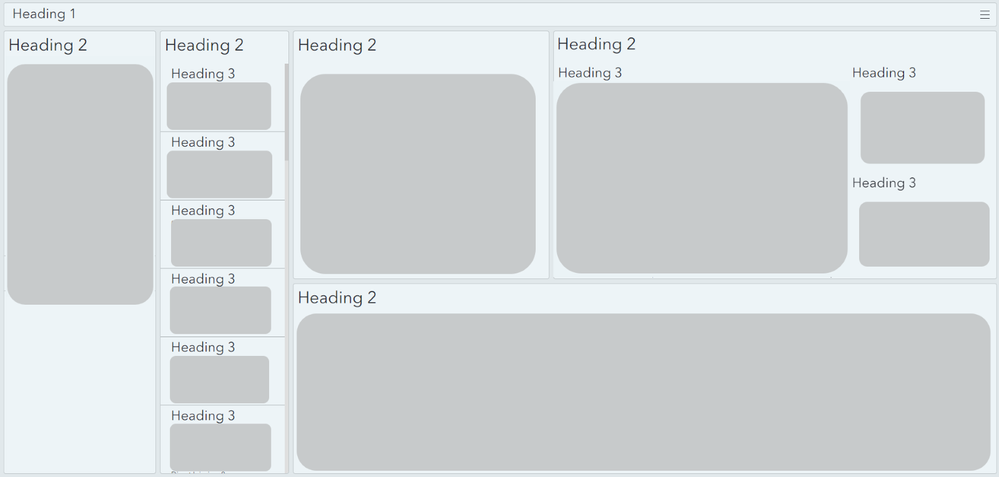

Headings should be used to create a text hierarchy and not simply to make text bigger or to stand out. In my current list, I have the event type in the middle of each feature row. I wanted it to stand out a bit, so I made it a heading. This is confusing and can cause screen reader users to potentially miss information as they may navigate into the middle of your content instead of the beginning. You wouldn’t put a title in the middle of a paragraph, would you? Of course not, that’s weird. Table of Contents don’t direct you to some random spot mid-sentence, so don’t inflict that on your users.
When it is appropriate for you to use a heading, ensure that the heading level is appropriate for the entire dashboard and not just that element. Here are some general heading guidelines:
  • Heading 1: Title of your dashboard.
  • Heading 2: A section of grouped elements or stand-alone elements.
  • Heading 3: Individual elements in a grouped section or heading within a List, Details, or Rich Text element.
Simplified dashboard showing element hierarchy.Simplified dashboard showing element hierarchy.
If you are struggling with headings, consider creating an outline of your dashboard content, just like you would for a paper.

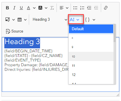

I frequently see people using a lower heading level because the appropriate heading level font size is too big. Remember, headings are for navigation and hierarchy, not font styling. If a heading is too big, simply change the font size instead of using a different heading level.
Font size button in the rich text editor.Font size button in the rich text editor.
I’ll go ahead and adjust my dashboard, so it has appropriate headers. I formatted my second level headings so they’re not as large; they are still tagged as Heading 2.

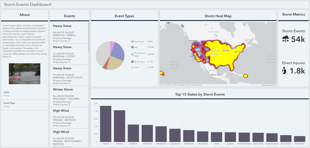

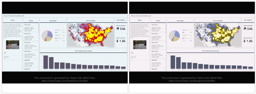

Here is our final dashboard, as well as what it looks like when we use Topal’s Color Blind Webpage Filter (link in the resources section) to simulate protanopia.
Note: This filter doesn't seem to load dashboards and webmaps properly. Instead I used a screenshot of my dashboard.
Final dashboard and simulated color blind dashboard.Final dashboard and simulated color blind dashboard.
What an improvement from the original dashboard! Making accessible decisions really did make this dashboard better for everyone
