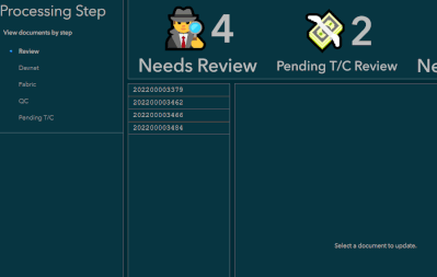

What I wanted was a single list of features, a status filter, and an embedded survey, but I needed it to be dynamic. Enter the Data Expression!

Next, I set my embed URL to:
https://survey123.arcgis.com/share/{form_id}
It's a bit simplified from what I used in reality. There are other attributes being calculated and passed as survey field:name=value URL parameters, etc., but here's the point: I now have one list, one embed, but I can access each of the three forms I need, and precisely where I need them.
The end product feels more adaptive, is nicer to look at and work with, and opens my dashboard up to fully utilize other widgets and layout elements without any redundant widgets!
Never mind the emojis, keep your eyes on the form.Never mind the emojis, keep your eyes on the form.
