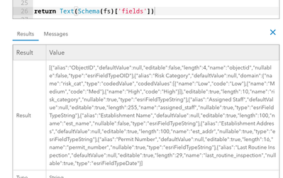

If you haven't tried it out yet, take a look at the Schema function, and what it returns:
Let's look closer at the fields object:
Isn't that what we want? Yes, it is! But we need to add our new fields to it. Enter the Splice function, which takes two arrays and just smooshes them together. Next time you run into this situation, try something like this:

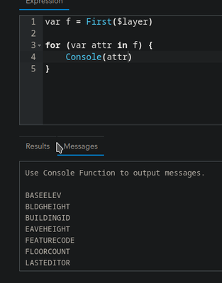

Consider this, though. Look what happens when you loop through a Feature:

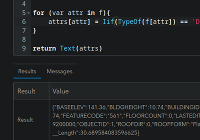

It's actually looping through the attributes dictionary keys! So check this out: we create a new dictionary, then push the feature attributes into it.

var attrs = {}
for (var attr in f) {
    attrs[attr] = Iif(TypeOf(f[attr]) == 'Date', Number(f[attr]), f[attr])
But, like the Schema function, this only helps us with the attributes that already existed in incoming FeatureSet, not our new fields. There's no Splice for dictionaries, but since we can create new values simply by calling dictionary['new_key'] = new_value, it's pretty simple:
