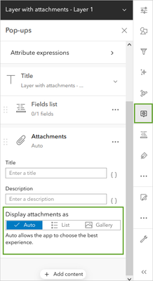

In ArcGIS Dashboards, the details element and any pop-ups in the map element are based on how your pop-up is configured in Map Viewer. Depending on the display settings of attachments in your pop-up, your attachments may display as a list (attachments show as links) or as a gallery (the whole attachment is displayed).
New maps authored in Map Viewer and stand-alone layers are set to Auto by default. Auto allows the app to choose the best experience for the attachment. For Dashboards, this means that your attachments will display as if they were in Gallery mode.
If your attachments are not displaying correctly on your dashboard, verify that they are set up correctly. Open your map in Map Viewer and in the pop-ups pane, check that attachments are set to display as Auto or Gallery
Pop-up configuration panePop-up configuration pane

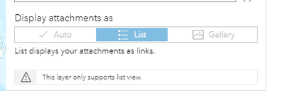

If you are in an ArcGIS Enterprise environment, depending on the version you are using, you may be restricted in how your attachments display.
Server-based layers and hosted feature layers from previous versions of ArcGIS Enterprise (10.9 and earlier) can only display attachments as a list. This means that on your dashboard, your attachments will always display as links. When you open your layer in Map Viewer, you will see the following message.
Pop-up attachment optionsPop-up attachment options

With the November 2022 upgrade in ArcGIS Online, all classic dashboards have forcefully upgraded to ArcGIS Dashboards. This has brought about a major challenge for those still using Enterprise referenced layers (not hosted) due to the display as list only limitation for images where a thumbnail preview of the image does not display. "BUG-000146647 - The Attachment (Feature Service) preview does not display in the Details element widget in ArcGIS Dashboards". Has there been a workaround for this issue?
@NooraGolabi @patrickbrennan1
GarretGiordanoTOLE
@Murage I second this. We are unable to get attachments to display in a dashboard that was not made in classic and originated from Enterprise 10.9.1.
PaulPetersen1
Agreed, this is a really bad regression.
