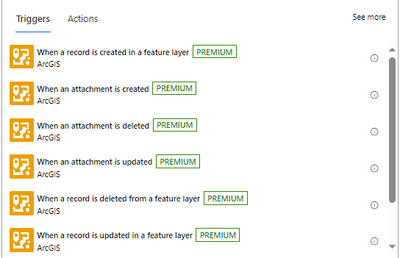

@LindsayRaabe_FPCWA - I know this post was from quite a while ago, but I am going through the posts on this forum and thought I would reach out. I am not entirely sure how helpful the ArcGIS Connector for Power Automate would be in this request as the connector acts as means to communicate with your organization's feature layers. There are other actions that are included (such as geocoding, etc.) which won't apply.
However, you can create a webhook on your feature layer whenever a record or attachment is created, updated, or deleted, and then create a flow based on that action.
Please let me know if you need any other additional information or if you were able to come up with a solution.
