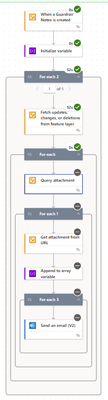

@Caitlin_Todd_LCOR , If the attachment is always created only when a feature is created then I would recommend you use something like this:
Else, Maybe another trigger like `When attachment is created` is more appropriate.

To piggy-back on this, here is an example of an output of ArcGIS Connector for Query Attachment:
    "statusCode"200,
    "headers": {
        "ETag""W/\"143-SEyQLGQQvSDupHamIqbh1v32DBI\"",
        "Vary""Origin,Accept-Encoding,Authorization,X-Esri-Authorization",
        "arcgis_connector_version""ArcGIS 2025.2.0 2025.06.10 1749573664471 361de8",
        "X-Powered-By""Express",
        "x-ms-environment-id""<redacted>",
        "x-ms-tenant-id""<redacted>",
        "x-ms-dlp-re""-|-",
        "x-ms-dlp-gu""-|-",
        "x-ms-dlp-ef""-|-/-|-|-",
        "Timing-Allow-Origin""*",
        "x-ms-apihub-cached-response""false",
        "x-ms-apihub-obo""false",
        "Date""Wed, 20 Aug 2025 22:47:34 GMT",
        "Content-Length""323",
        "Content-Type""application/json; charset=utf-8"
    "body": [
            "id"133,
            "globalId""<redacted>",
            "name""IMG_2351.JPG",
            "contentType""image/jpeg",
            "size"4568873,
            "keywords""attach_images",
            "url""https://services3.arcgis.com/<redacted>/FeatureServer/0/567/attachments/133"
The body value is an array of attachment attributes (not the attachment itself). If no attachments are found for the specified objectid, the array is empty: []
As @AkshayHarshe pointed out, you would then use ArcGIS Connector Get attachment from URL to get the actual raw attachment file data for each attachment via the "url" value from each attachment you're iterating over from the Query attachment body.

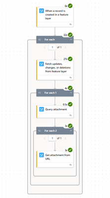

Is this running on Enterprise or Online? Try using Query attachment. and use the dynamic content from the fetch action. I will check if there are anyissues.
Thanks,
Akshay Harshe
Caitlin_Todd_LCOR
This is running on Online. I tried Query but the Fetch action didn't recognize any attachments to be queried. When I try to test the flow it skips right over Query Attachment as it couldn't find anything to query.

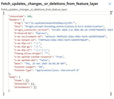

This is the raw output from the Fetch action. Even though I tested with a newly created point feature it didn't fetch anything.
