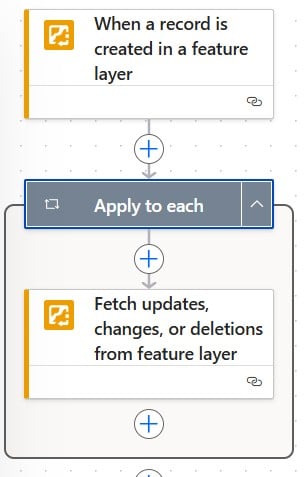

We are on government Power Automate. I did a test just now by creating a new hosted feature layer (HFL). I created a flow like in your example to trigger based on new record creation. I had to go into the HFL and manually enable "Keep track of changes to the data (add, update, delete features)" in order for the webhook from the flow to be created.
Creation of new records did not trigger the automated flow.
I turned the flow 'off' which removed the webhook, turned it back on to create a new webhook... but it still does not trigger.

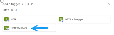

One other thing you can try is to create a webhook directly using HTTP Webhook trigger available in OOTB in Power Automate. See if they work when you completely bypass all the triggers in ArcGIS Connector.
If they still don't work then it is not related to ArcGIS connector and probably an issue with ArcGIS Online. If they work with this and not with ArcGIS triggers then we need to investigate this further.
You can take this completely out of Power Automate and test webhooks using something like webhook.site.

Our TS are saying the connector payload is an Object.
But it is expecting an array, please see attached image
