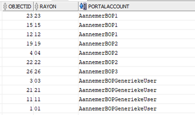

In our case we use a 'district' table with a field 'PortalUser':
A trigger on this table pushes any update or change to the created_user field of the dataset we're using for the service(s):

We use this in Oracle, but you can use the same thing for the PostgreSQL db of the Data Store.
Work nicely, really; any change is directly visible in the webmap. The update trigger is trivial; 0.5s for 10k rows.
