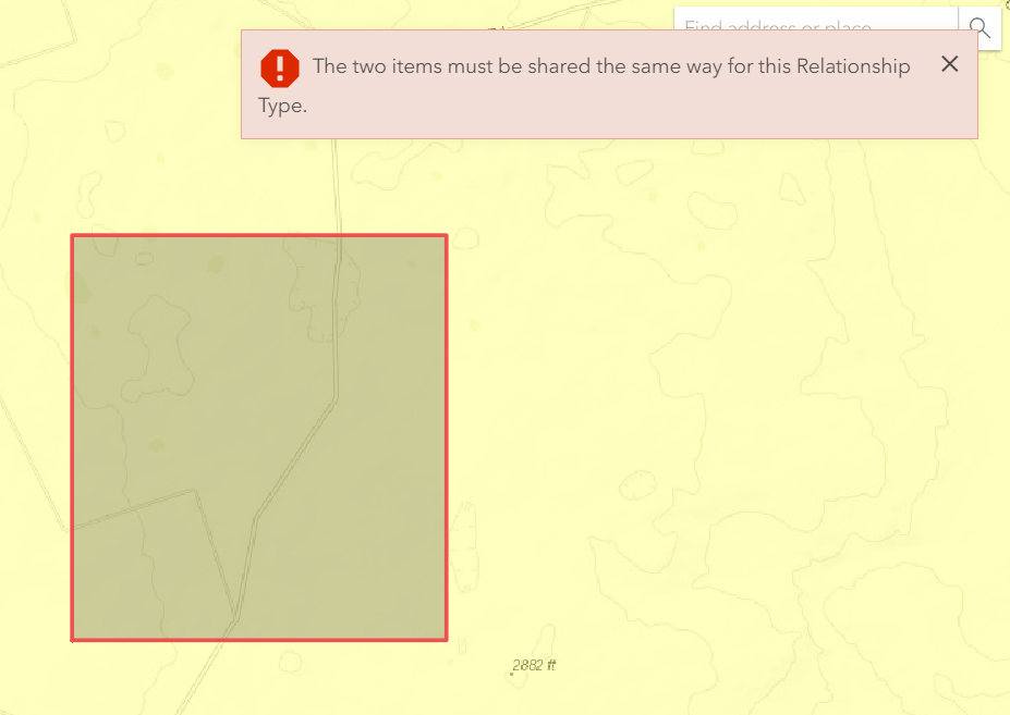

I am trying to use ArcGIS Online to create a 'map area' for offline use in Collector. After drawing the map area I receive an error message, "The two items must be shared the same way for this Relationship Type". When I create the map area in Collector itself there is no error, but I want to create in ArcGIS Online so I can easily allow others to use. Any suggestions?

I am having the same problem. For me the share settings for the map and the hosted feature layer look identical.

Robert -- same for me.  The share settings are identical in my situation as well.

Did either of you find a solution to this?  I am getting the same error.

I talked to ESRI Support today and they confirmed that this is a bug (BUG-000119242) in the system but it will be fixed with the next version (7.1).  The workaround is to turn off all sharing and then go in and make your Map Areas.  It worked great for me.  Make sure to turn off all sharing include the Sharing that you can do directly from the Content window.

Thanks for perusing this, I got bogged down by AppStudio on another issue. I turned off sharing on the map (left the layers as is) and I was able to generate the map areas. Sharing is back on now. I will test with collector in a day or two.

I experienced this issue today in the latest version of ArcGIS Online. Your suggested solution of turning off all the sharing settings for the map and all layers within it worked for me. However, you said that the bug was fixed in version 7.1, and the current version as of today is 8.4. Could this be a new bug with repeat behavior?

I keep running into this issue too. Seems like a possible regression? It's really frustrating. My work around is to make people generate their own offline areas; my maps are too complicated to turn off sharing for every layer a practical thing. 😞

It's now 2022. Issue still remains. Turned off all sharing. Error message appeared.
