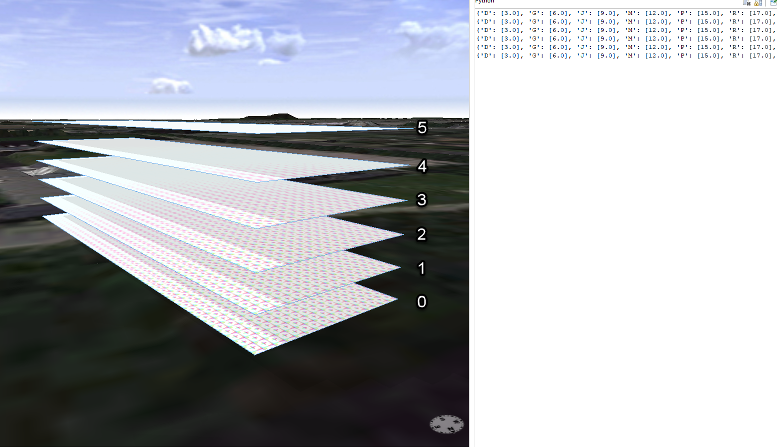

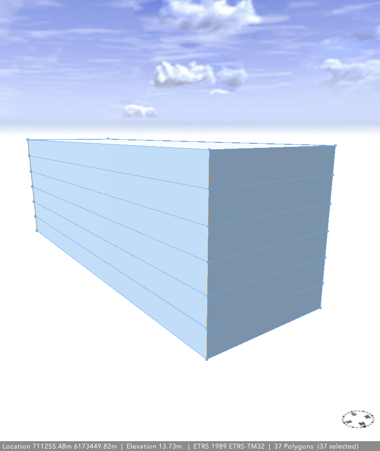

The models are not created in CE but is CAD export to shp. It's one shape, but it contains floors:
I'm able to do a component split and get the facades and floors isolated, but a building can have multiple floor parts in the same level, and in this simple example it get's confused on what's actually are the order of the comp.split.
So I need to be able to pick out a specific index, and therefor I need it to be indexed as below (likek we are use to)
I've created a rint(scope.elevation-elevation) after a component split, and created a loop so I get it in the right sort order. Like elevation = 3,6,9,12 etc. but since it's an component split I can't compare them to each other, so CE don't know that in this case the elevation on 12 is equal index 3.
and if i have a building with a floor height on 4 meters the elevation 12 would be index 2.
If I could only get those elevation into a sorted list, and remove dublicated values, then I could use the list capabilities + the elevation information to pick the right floor.

If a floor is 3 meters, I'll get  a report called D, with the height.
In the first part of the tutorial 12 that will create a list like:
{'D': [3.0], 'G': [6.0], 'J': [9.0], 'M': [12.0], 'P': [15.0], 'R': [17.0]}
So if I can get that converted into a list like:
3;6;9;12;15;17 and add it to the object attribute of all my models so I can link it back to the attributes, then I'm sure I can get it to work.
