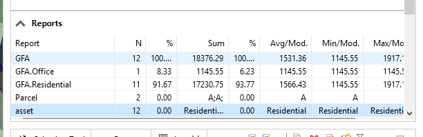

The report on floor areas comes through as expected in the reports panel, when lots are selected.

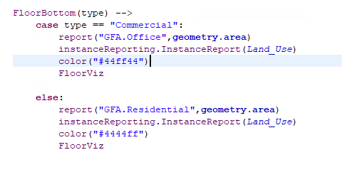

Following tutorial 12, I've added the InstanceReport attribute into the rule that creates the floors, next to where the areas are reported:

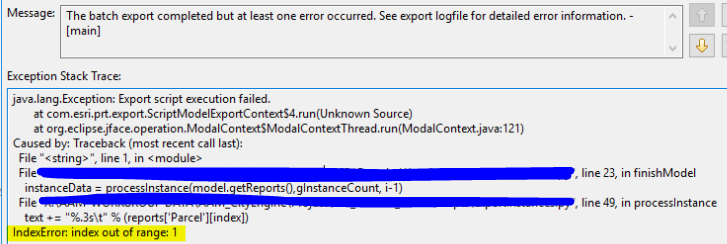

I'm running the exportInstances python script, but get an 'IndexError: index out of range: 1' error:

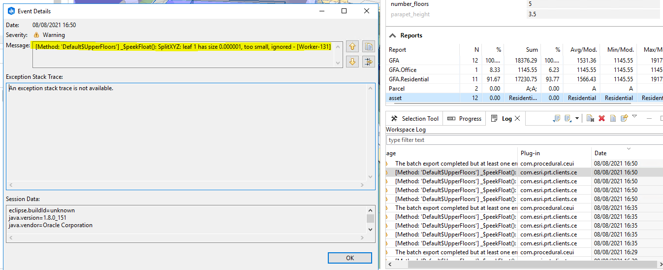

In the log I also have this error - I'm wondering if this means the floors are being ignored because they are a 2d plane, with no thickness? Or am I misinterpreting..
