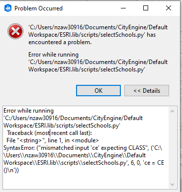

I've made the suggested changes but unfortunately it is still not working, receiving either the following error or nothing at all happening, depending on where I put the @noUIupdate
Below is the code. Any other advice?

JonasObertuefer
hi again,
  • @noUIupdate needs to be directly above the function you want to trigger no UI updates
  • change the filter in your getObjectsFrom() from ce.isGraphSegment to ce.isShape. Amenity is isuallay a object attribute assigned to shapes.
I tested the the code below, and it works for me:
