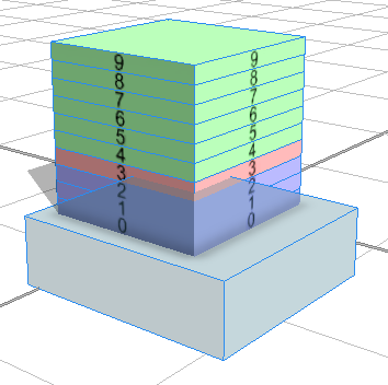

I'm dividing a building into horizontal slices and running an occlusion query, which colors the slices according to the touch results. I'd like to color the last slice touched in a different color. However, I can't figure out how to actually catch the last index. When I print the split.index the results are ordered in the console, suggesting that there does seem to be a way to catch the last split. Is it possible?

Result, with manual setting of the split index:

Thanks, but I'm not looking for the entire split count, just the number of the last one that triggered the touch(). So split.index 3 in the example. Obviously I can't tell which number it is when I use the rule in multiple buildings with different elevation.. If I change the rule to this:
TouchCheck -->
  case touches(inter): Touched
  else : NotTouched
Touched -->
  print("Touched, "+split.index)
NotTouched -->
  print("NotTouched, "+split.index)
I get this ordered output:
Touched, 0
Touched, 1
Touched, 2
Touched, 3
NotTouched, 4
NotTouched, 5
NotTouched, 6
NotTouched, 7
NotTouched, 8
NotTouched, 9
so I thought maybe there's a way to catch that last "Touched" split.
