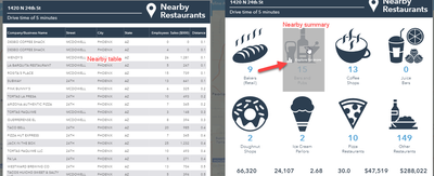

I cannot figure out how to interact with the output of the "point count" variable from the nearby locations tables. In the attached image, I have circled the output variable that I am trying to interact with. Ideally, I would like to use this number to calculate variables such as "number of grocery stores per person", etc.

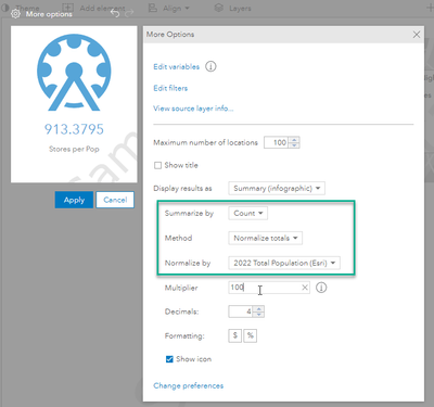

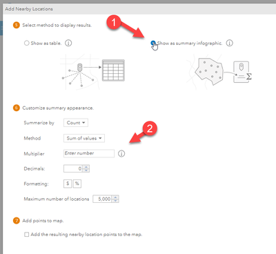

My recommendation is to use infographics instead as it provides more options when creating nearby tables. You can use the summary infographic option to calculate your variables. Learn more about building nearby infographics.
Once you build the summary infographic, you can view additional attributes by clicking Explore for more when running the infographics. You can use the Nearby Restaurants infographic template as an example. Notice it has a nearby table and also a summary.

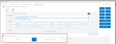

In the nearby workflow, you can only normalize the count of the nearby grocers by the total population.

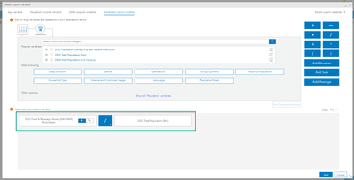

If you simply want the number of grocers/total population using the Esri Business data, creating a custom variable as follows might be the best option.
If you have your own point layer and want to summarize the count by creating a custom data, the process might be a bit complicated but it can be done.
First, your layer must contain a field and populate that field with "1" for all features. Then create a custom data using this field. Basically this field will be used to create a summary count of all the businesses in a specific area. You can add the custom variable in classic reports or infographics.
