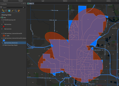

Hi Michael - thanks for the post.  I want to make sure I understand what you are trying to do here.  Are you looking to extract underlying geographies (i.e. Tracts, Block Groups, etc.) that are completely within/intersect/have center within a Customer Derived Area boundary?
If so have you tried the Generate Geographies From Overlay tool?
Here's an example output.  I want to see which block group boundaries (blue/purple) have their center within my Customer Derived Area (red).  The white points are block group centroids.
