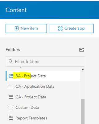

  • Sign into ArcGIS Online, then browse to Content > My Content and then go into BA - Project Data folder (as shown in screenshot above)

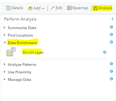

  • Once the layer shows up in the Web Map > Click Analysis > Data Enrichment > Enrich Layer (enrich your layer with the variables you want). Note this will create a new layer and the attributes should now have the population variables

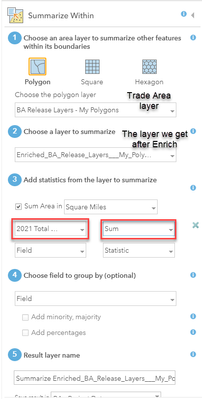

  • Then add the other layer you want to summarize the data into. And use the Summarize Within tool under Analysis > Summarize Data
  • This tool will also output a layer that has the population attributes summarized.
