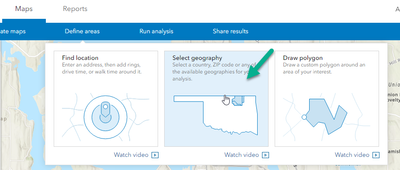

@JayLarsen
You have so many options to get demographic information for your sites. Simply start by defining the sites you need using this workflow:

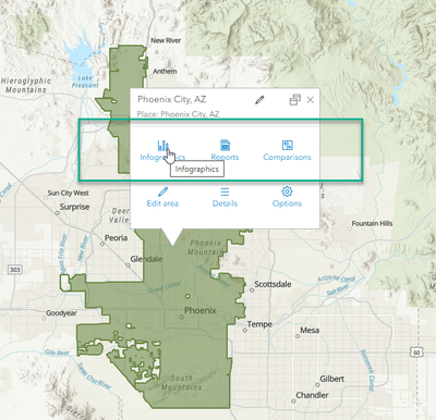

After you define the Phoenix city boundary, you can use one of the available options here to get the demographic data in any format that works for you :
