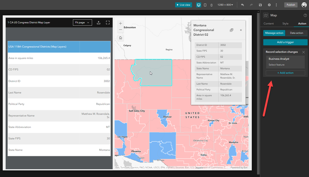

You must be missing something in the workflow as I tested this using a sample web map from the Living Atlas and confirmed that the infographic loads fine as you can see:

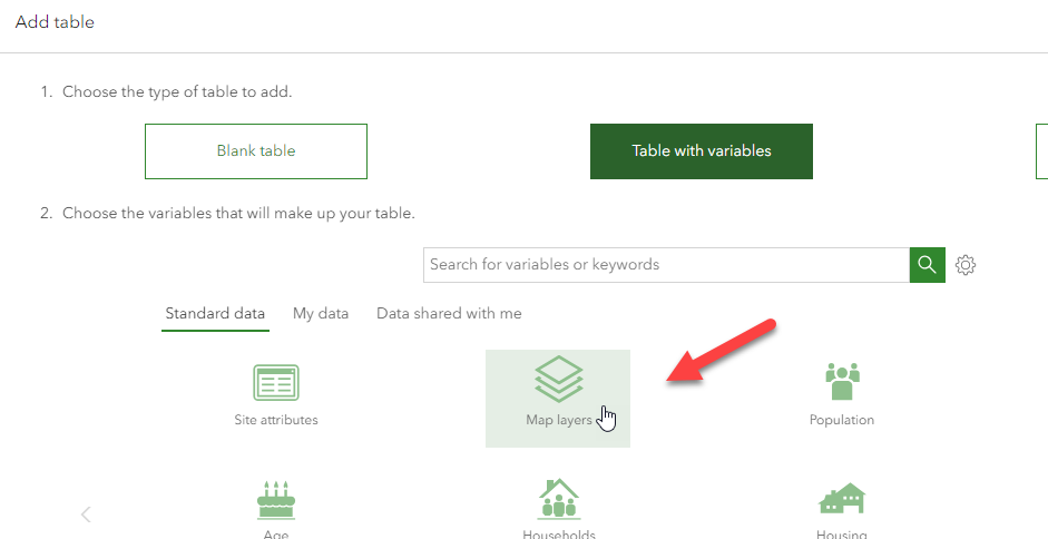

I used this web map: https://www.arcgis.com/home/item.html?id=521fa0defa054c389097e685328d4bc3 to create the infographic in Community Analyst using the Map Layers category to get the variables from the layer:

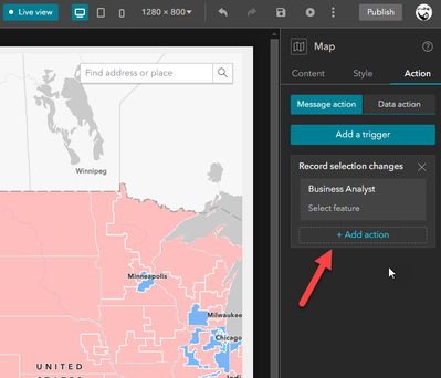

The other key step in Experience Builder is to make sure you use the same exact web map in the Map widget and also make sure the action message is configured as follows for Business Analyst widget:

Thank you so much!! You're right, the problem was that I did not configure the action message.
