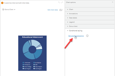

With the upcoming November release of Business Analyst App, you will have a new option to apply conditional styling to pie and donut charts that will enable you implement the enhancement you requested above.
Here are the additional steps you need to follow to get the desired behavior:
1. Edit your chart and enable conditional styling.
2. Select Top and bottom from the Calculation method dropdown menu.
3. Select Nth greatest from the Bar value dropdown menu.
4. Click + Add condition and add more top N values as desired. Here is an example of top 3 values with a custom color ramp.
5. Customize the colors as needed and click Apply.
6. Expand the chart option and apply a default filter as follows:
7. Optionally, scroll down and enable sorting.
8. Apply and save your template. When you run the infographics, the chart will show the top 3 values with your customized color ramps as follows:
