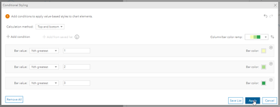

2. Select Top and bottom from the Calculation method dropdown menu.
3. Select Nth greatest from the Bar value dropdown menu.
4. Click + Add condition and add more top N values as desired. Here is an example of top 3 values with a custom color ramp.
5. Customize the colors as needed and click Apply.

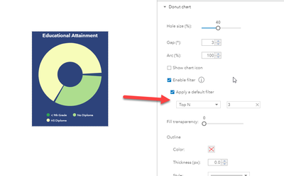

6. Expand the chart option and apply a default filter as follows:

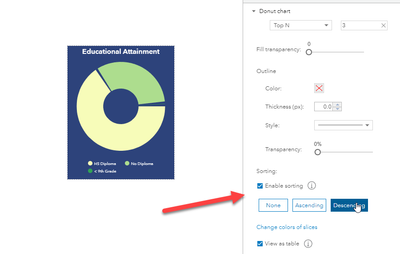

7. Optionally, scroll down and enable sorting.

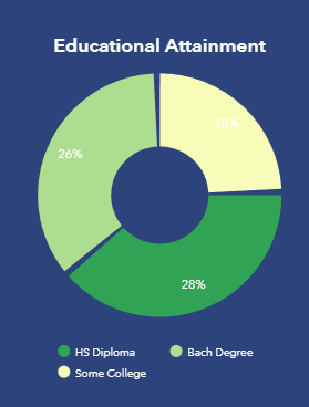

8. Apply and save your template. When you run the infographics, the chart will show the top 3 values with your customized color ramps as follows:
