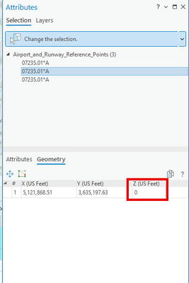

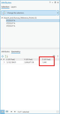

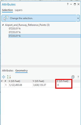

Hi @CarieErnst_KYTC & @KYTCGIS - just piggybacking on Sara's response to add some more specifics based on the data that you shared.
For the specific airport you described, I found the ARP and Runway End points in the data you sent.  The ARP has an elevation (and corresponding z-coordinate) of 1040 ft.  However, the runway end points have an elevation and z-coordinate of 0 ft (see images below).  This huge gap is what the warning message is describing.
To address the warning, ensure that the z-coordinate of the runway ends (specifically the vertices on the RunwayCenterline feature) is updated to the appropriate elevation.  You can fix this manually using the Edit Vertices tool on the Edit ribbon.
As Sara mentioned, the warning is triggered when the vertical difference between the airfield elevation and the runway ends is more than 150 ft.  This is because the horizontal and conical surfaces are built relative to the airfield elevation (150 ft above), while the other surfaces are built relative to the runway ends' elevations.  If the difference is too great, it can cause issues with the transitional surfaces.

KiyoshiYamashita
