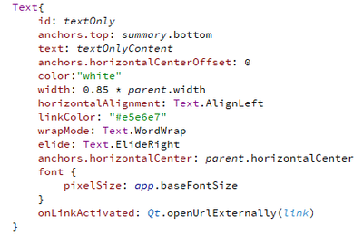

Check out Qt.openUrlExternally()
https://doc.qt.io/qt-5/qml-qtqml-qt.html#openUrlExternally-method
I'm using it successfully in a Text QML element like so:

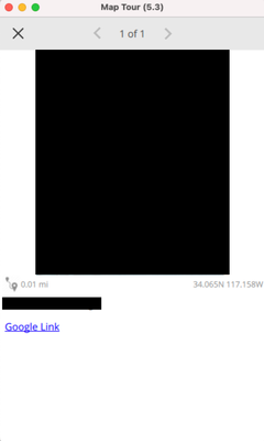

Hi @JoshBillings ,
When creating or editing a StoryMap, you can also simply add html to add a link to your story. It can look something like:
<a href="https://www.google.com" target="_blank" style="">Google Link</a>
Which would produce something like the below screenshots.
Screen Shot 2022-05-11 at 2.12.07 PM.pngScreen Shot 2022-05-11 at 2.12.07 PM.png
Screen Shot 2022-05-11 at 2.15.03 PM.pngScreen Shot 2022-05-11 at 2.15.03 PM.png
Note, this approach would open the url link within the app and not launch default web browser apps. Hope this helps.
