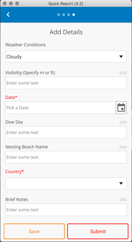

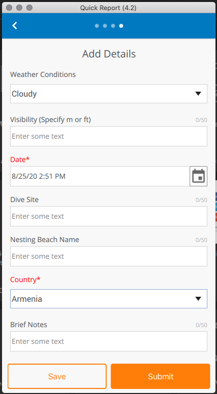

I want to follow up request this question, I think this feature is already added on Quick Report on AppStudio 4.2 and above. I tested this using this feature layer, https://services1.arcgis.com/JXBurs0uwQlwOiHt/arcgis/rest/services/TURT3/FeatureServer/0 , that has required fields, Date and Country (nullable: false).
Thank you,
Erwin
