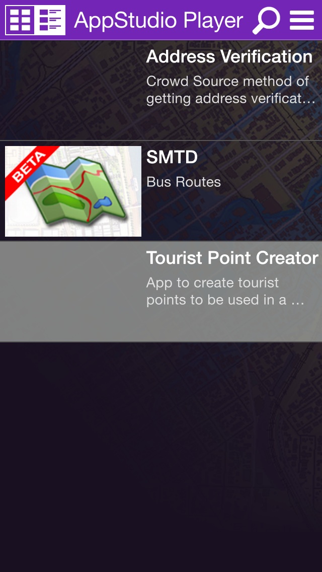

Downloading App to the iPhone or iPad using the Player App:
  The iOS player displays downloading and runs up to 100% but then it stops and message does not go away.  I close the player app and open it again to solve the problem.  The downloaded Appstudio app will then be there and will run.  Notes: iPhone 5 64 GB with iOS version 8.4, iPad

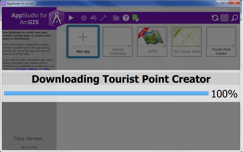

Downloading App to AppStudio Desktop:
I only have a 64 bit version of this application on my Office workstation and on my Home PC but I have the same problem as I have on the iOS AppStudio Player.  The downloading runs up to 100% and then freezes.  Have to close the AppStudio application and start it again.  The app that was downloaded will then work as it was downloaded 100%. See image uploaded
Thumbnail image:
Thumbnail does not show up in the desktop app or the player app (in iOS) I don't know about Android.
When you log in to your orginazation account and the app has not been loaded on the device yet you will see the thumbnail image.  After you download the app the application Title will be displayed but with a blank thumbnail.  (See attached images).

Here you can see blank thumbnail in the Desktop Application and you can see the Download info stuck at 100%.  This only happens to when using the Quick Reports.
Blank thumbnails in IoS  (the download freezes in iOS Player as well).

Just to be clear.  The downloading problem and the blank thumbnails only happen when I use the quick report template.  I have actually loaded thumbnails of the correct size.  But they never show up.

We have also observed the downloading app freezing at 100% - but it has been intermittent. Thumbnail appearing blank is known - do click the refresh button to display the thumbnail after download. We've seen it with apps built from templates and also new apps.
