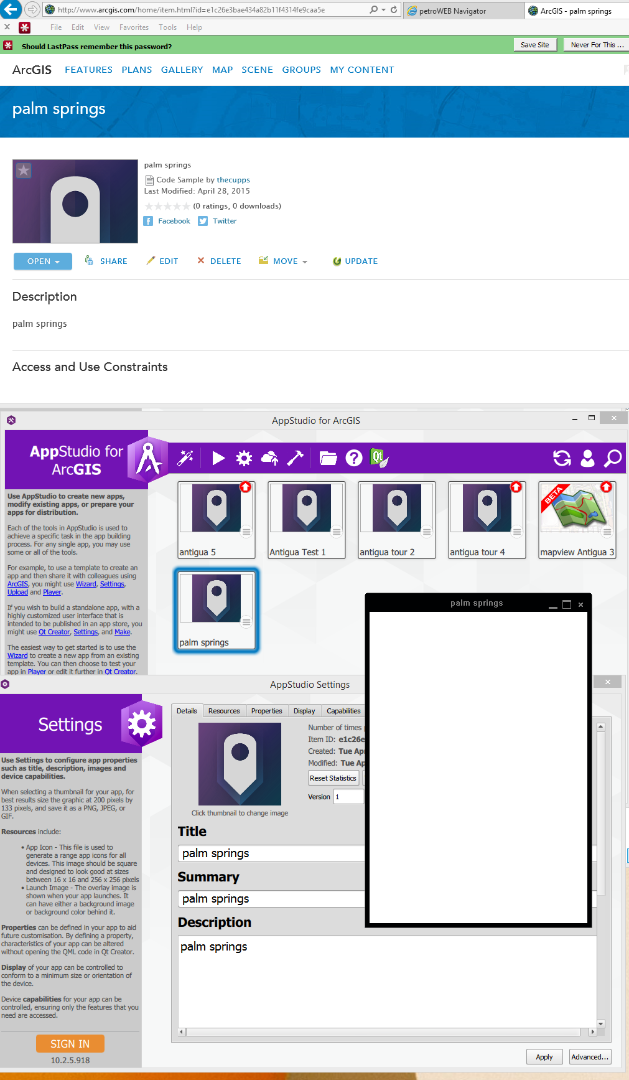

When I create an app using AppStudio.
If I use the Map Tour Tempalate EAP3, it seems to build (and I can upload to my arcgis online account), but when i try to 'run/play' from App Studio it crashes immediately..
     "ArcGIS AppBuilder Player   ArcGIS AppBuilder Player has stopped working   Windows is checking for a solution to the problem..."
If I use the Template Map Tour Template Beta 2, it runs, and I get a blank outline but nothing inside..
I tried to follow the AppStudio for ArcGIS: Building Native Cross-Platform Apps | Esri Video  exactly.. including using his webmapid, but i get the same results every time.

Just spotted this post - I hope that you have managed to get further by now. If not, or for others here's some info.
The blank screen is most likely to do with a discrepancy between the version of the template and the version of AppStudio. Check which version of AppStudio you have - is it Beta 2? (the latest version) If so you will need to build an app from the Beta 2 template.
Apps that were created in earlier versions of AppStudio can still run, but you will need to change an import statement in each of the QML files. Open the app in Qt Creator and change:
    import ArcGIS.Runtime 10.2.5
to
    import ArcGIS.AppFramework.Runtime 1.0
