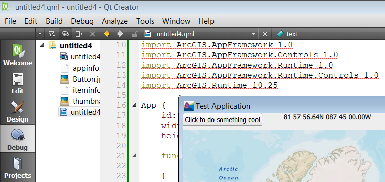

Pardon the newbie question - I've managed to install App Studio / Qt Creator and am getting up to speed using the "ArcGIS Runtime QML Sample App".  I copy/pasted the code from the "Mouse coordinates" sample into Qt Creator, and I modified a line or two.  I can run my tweaked out code by going to: Tools>External>AppStudio>Player (Alt-P is the short-cut).  That works great!
But now...
What I want to do now is add an onMouseClicked handler to the map...unfortunately, something in my code isn't working. So i'd like to debug. How do you do that? Setting a break point in Qt Creator doesn't seem to do anything.  In Qt Creator, there are options under Debug > Start Debugging, but I'm not sure how to use those tools (is that even the way to go??).  There's  mention in the documentation about using Visual Studio and WinDBG - I have Visual Studio on my machine for ArcMap development, I should already have WinDBG, right?  Is WinDBG the way to go, and if so is there some more info on how to use it in an ESRI AppStudio context?
Perhaps the problem I'm having is that I'm getting "QML Module not Found" squiggles in my .qml file (although the AppStudio player seems to not care).

The red squiggles in your screenshot are the first issue. They shouldn't be there and it might be to do with version. At beta 2 we did change the name of modules so
    import ArcGIS.Runtime 10.2.5
should be changed to to
    import ArcGIS.AppFramework.Runtime 1.0
(ie: you don't need both).
