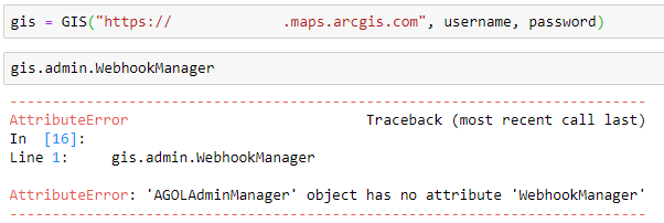

When will WebhookManager be available for ArcGIS Online? Looks like it was released at 1.6.0 @KevinHibma ?
Maybe there is another way to administer webhooks on hosted feature layers on AGOL using the Python API. Any help, ESRI Community? I was hoping to use the Python API but calling REST directly isn't a problem.

I believe you're correct it was added in 1.6. I'd suggest using at least 2.0 or higher as I know the team fixed some bugs with it.
Try this code snippet to create/manage webhooks
from arcgis.gis import GIS
from arcgis.features.layer import FeatureLayerCollection
gis = GIS("https://www.arcgis.com", "username", "password" )
# Find your layer item
i= gis.content.search("webhook")
# I know I only have 1 feature layer named "Webhook" so I can cheat with the index
flc = FeatureLayerCollection.fromitem(i[0])
mgr = flc.manager
wh = mgr.webhook_manager
wh.create("My WEBHOOK", "https://webhook.site/aaabbb11223", "FeaturesCreated")

PhilLarkin1
Gotta pull it from FeatureLayerCollection. Okie Dokie. Thank you!
