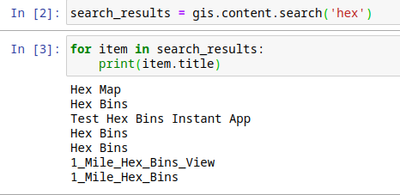

for item in search_result:
    print(item.title)
The list search_result already has the title as a property of each Item in it. You can reference the title directly in your loop.
