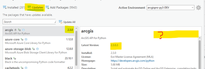

I'm struggling to update the arcgis package. I upgraded ArcGIS Pro to 3.3 which upgraded the package to 2.3.0. Now ArcGIS Pro Package Manager won't give me an option to update. pip install arcgis assumes I have the latest version, which I do not. This appears to be an unrelated issue.
Nonethless, 2.3 0 of the arcgis package still throws an error, slightly different, but still present.

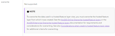

You know what? The more closely I look at the source the more it's apparent that "overwrite" option doesn't do anything!
This is the only thing it actually does:
        if overwrite:
            _log.warning(
                "overwrite is currently not supported on this platform, and will not be honored"
And reading the documentation:
I'm so sorry to have led you astray here. I didn't run create with overwrite myself and so didn't catch this earlier. It seems absolutely pointless to add this parameter if it doesn't do anything at all.
