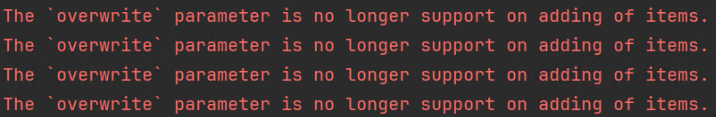

The upload is successful in Pro 3.3.0, but I now receive this warning message:
Attempting to re-run the script (and overwrite the previously uploaded VTPK) results in a new error:

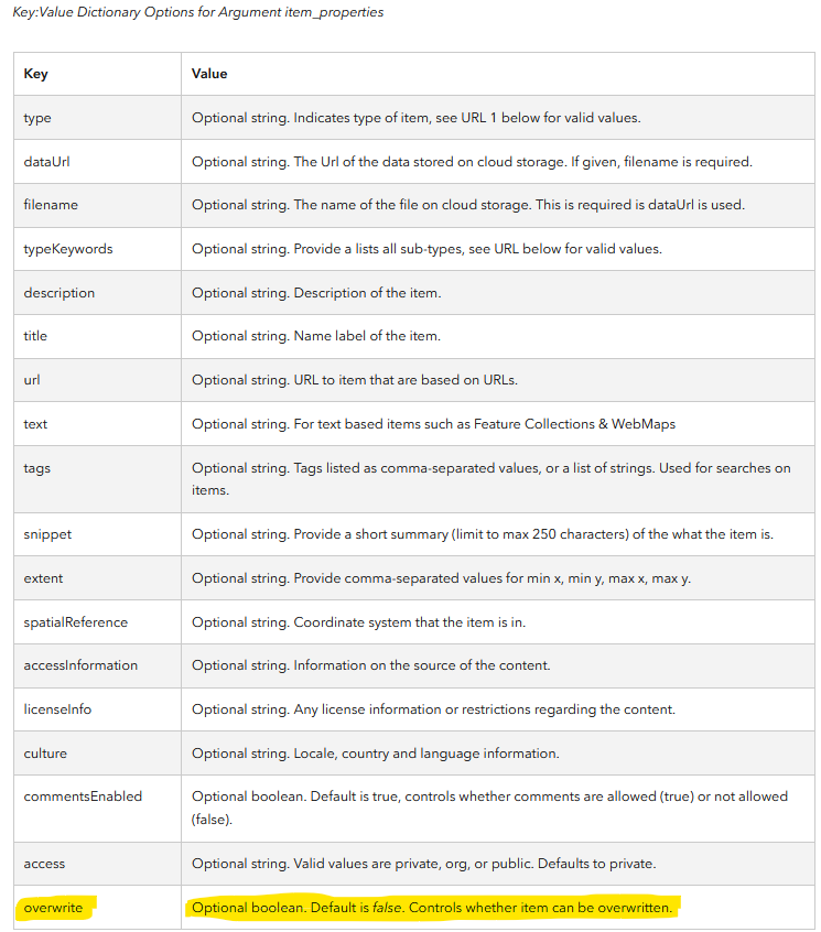

The error makes sense, since 'overwrite' parameter has been deprecated. However, I have been unable to find any details about this deprecation. Confusingly, the current item_properties documentation for content.add()  still show 'overwrite' as an option:
The overwrite parameter would overwrite the file uploaded to AGOL if the name/file already existed. We liked that feature (sometimes we need to re-run the content.add() workflow more than once a day if a quick replacement is needed for the same VTPK). The naming convention of the VTPK upload has been YYYYMMDD_AgencyName_BasemapAffiliatedName. I could start including HHMMSS to help keep the duplication from occurring, but I'd rather just use a parameter that accomplishes an overwrite if a new one was created.
