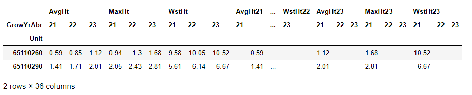

Hi @ejuser ,
Pivot method in pandas might do what you are looking for. See below:
import pandas as pd
df = pd.read_csv(path to csv file)
df.pivot(index='Unit', columns='GrowYrAbr', values=['AvgHt','MaxHt','WstHt','AvgHt21','MaxHt21','WstHt21','AvgHt22','MaxHt22','WstHt22','AvgHt23','MaxHt23','WstHt23'])
you can change the index and columns if this is not the result you are after.
Hope that's helpful.

ejuser
Hi,
I appreciate your insight. My goal is to flatten the table such that each unit has growth model heights for year 2021, 2022, 2023 on one row so it can be joined with a feature class in a one-to-one relationship.
I wonder if I can store the attributes for the three years of growth for each unit and write it out in another file as one record as opposed to three? I will continue to explore this. Thanks for taking the time to respond.
