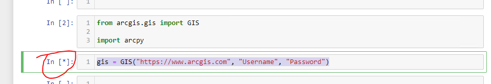

Hi,
I have a few python scripts that I use to update some of our maps over night.
I am in the process of moving these scripts from my computer to a VM so other team members will be able to access and maintain them if required.
However I am having issues using arcpy in the VM.
When I try to sign-in in the script using:
gis = GIS("https://www.arcgis.com", "Username", "Password")
The script will try and run that line but it will just hang there indefinitely without any error (I waited for a few hours before killing it).
Screen shot of Jupyter attached.
The VM is running Win 10 and has ArcGIS Pro Desktop installed and signed in.
I am also able to connect and grab content in ESRI online from the ArcGIS Pro Desktop.
I'm hoping someone can point out if there are some network or firewall settings I can discuss with our IT to try and sort this out.
DanPatterson
MVP Esteemed Contributor
don't use it, but you didn't indicate whether you had seen the documentation and requirements for virtualized environments
