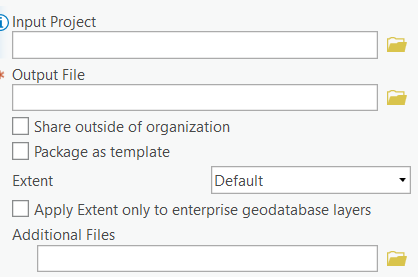

I am building a Task Workflow to automate deployment of Crowdsource Polling. I have a task for creating a feature layer from a spreadsheet that sets up a relationship class between the feature layer and related commenting table. Once this is finished I need to symbolize the layer based on a field in the comment layer. I have created a layer file to accomplish this need by symbolizing based on layer file. I have got this to work before packaging the project but need it to work from within a packaged project. When I use the Package Project tool I have saved a the layer file (.lyrx) using the "additonal files" input:
This adds the .lyrx into the commondata folder of the package.
My issue is that when I get the path for the .lyrx and plug it into my code I am getting a ValueError. When I do this before packaging the project I do not get a ValueError. I have also tried running the code from the package after I use the extract package tool and get the same error.
