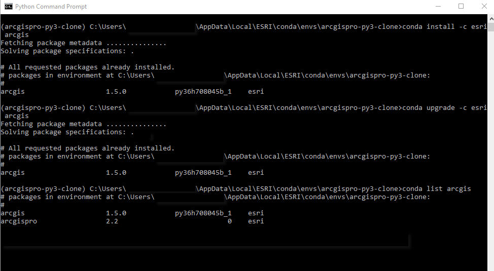

What did it say in your console? was there an error? you do have the package installed, and did you run it from the clone?

Here are some screen shots.  I did get an error when I tried to load a map,
Partial list of packages:
