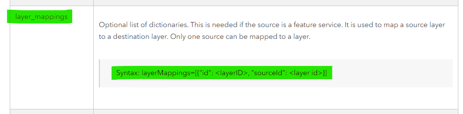

curious, since the syntax in your link shows
layerMappings=[{“id”: <layerID>, “sourceId”: <layer id>}]
... sort of retired...
oregonparksgis
Yeah I can't figure it out, since the help shows both
I've tried that other way as well and get the same TypeError: append() got an unexpected keyword argument 'layerMappings'

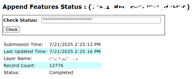

In the Feature Service case, manually entering the parameters from the REST endpoint interface works fine.
https://services.arcgis.com/********/ArcGIS/rest/services/******/FeatureServer/3/append?token=******
So the issue appears to me to just be the python syntax. I've opened a support ticket so we'll see if that gets it resolved.
