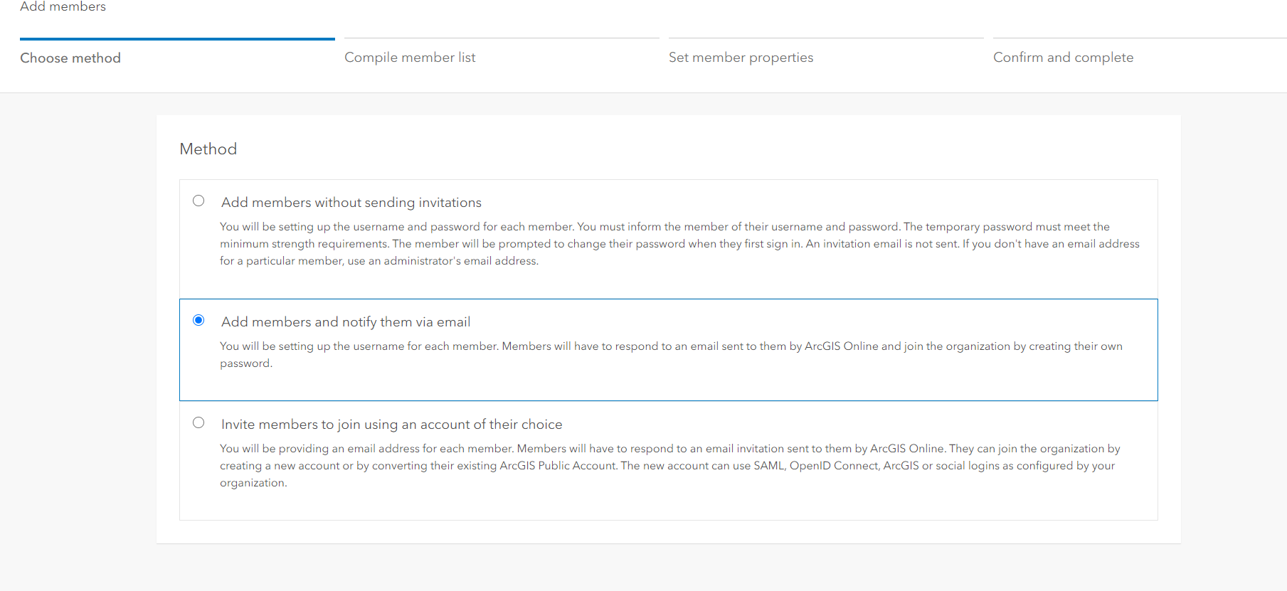

Question is essentially the title: is it possible to create accounts using the python api that's a replication of the 'Add members and notify them via email' style used in the GUI (see below)?
Our workflow is going to involve ingesting a list of hundreds of names from a survey, verifying them, and then creating hub community accounts. The preference would be to do so in a way that lets the user set their own password rather than provisioning them one.
I've been able to create users just fine, and then send a notification email just fine, but I don't like how the process is separate and the fact that a notification email comes from me, rather than the ArcGIS Online system. Examples below:

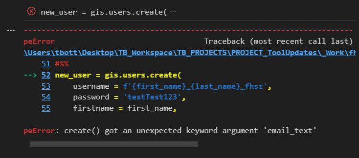

It would seem that just using the .create() method could generate the GUI-style email, as, according to the documentation, there's an 'email_text' argument (see below). However, when attempting this I get an error saying that the 'email_text' argument is unexpected.
create(usernamepasswordfirstnamelastnameemailroledescription=Noneprovider='arcgis'idp_username=Nonelevel=2thumbnail=Noneuser_type=Nonecredits=- 1groups=Noneemail_text=None)
emailText = 'This is a test email! You have been invited to join this community extravaganza!'
new_user = gis.users.create(
    username = f'{first_name}_{last_name}_fhsz',
    password = 'testTest123',
    firstname = first_name,
    lastname = last_name,
    email = email,
    credits = 50,
    role = 't8qahvxvKEh6uNyT',
    user_type = 'creatorUT',
    groups = '<987ce15a07694fa6bf9ec45cd6241b7b>',
    email_text = emailText
Any help would be appreciated. It would be much better if we could mimic the GUI-style sending of an email, rather than creating the usernames and then sending them an email to try to log in.

Wonder if you might be using a pre-2.2.0 version of the ArcGIS for Python API, which would not include the  email_text parameter? (What's new in version 2.2.0?)
SFM_TravisBott
@PeterKnoop You were right. After faffing through upgrading Pro, getting my python environments switched out (since Pro wouldn't accommodate updating my previous ones), I now have the updated 2.2 version of the arcgis module which allows the email parameter.
