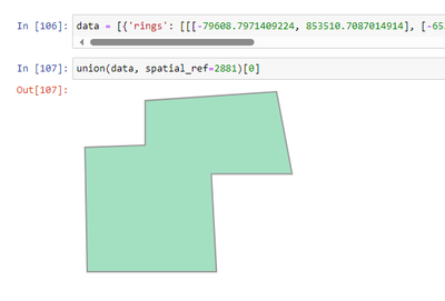

I tested your example and it works fine for me:
I'm on version 2.3.0.1 of the API. My guess is maybe your version isn't correctly parsing that JSON into geometry objects?
Any difference if you explicitly parse into Polygon objects beforehand?
