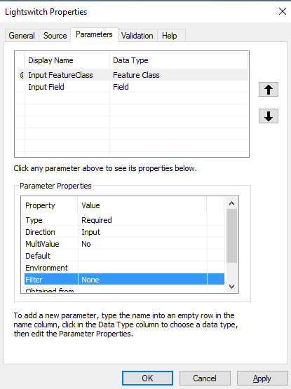

Hi Devon,
For the 3rd parameter, set the Data Type to a String, Multivalue to Yes, and Filter to Value List:
You can then use Validation tab to populate this Value List:
def updateParameters(self):
  if self.params[0].value and self.params[1].value:
    self.params[2].filter.list = sorted({row[0] for row in arcpy.da.SearchCursor(self.params[0].value, self.params[1].value.value) if row[0]})
This will give you the following:
