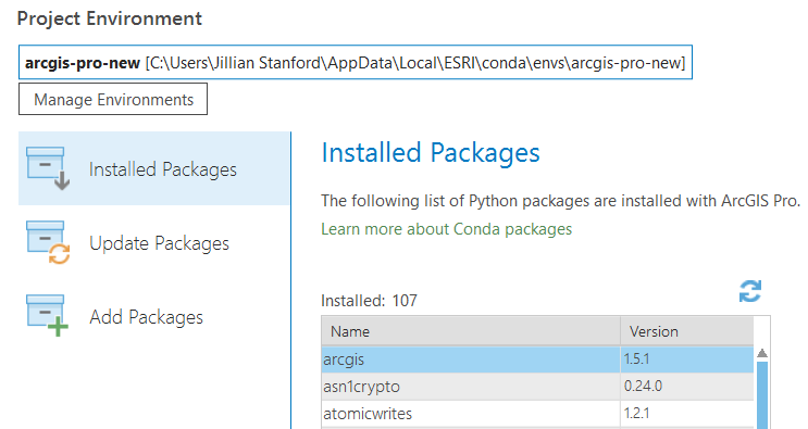

I see that whichever environment I set as the active environment in the Python Package Manager in Pro is the environment that the Python Command Prompt opens with as active. Try going into Pro and click the Manage Environments button and then click the radio button next to the arcgis-pro-new environment - you should get a message in the dialog stating you need to Restart Pro for the change to take effect. So Close the Python Package Manager and then close Pro. Then try starting the Python Command Prompt - does it start with arcgis-pro-new as active?

Yes, I've tried switching back and forth using the manage environments dialog and the command window always opens in arcgispro-py3.

I tried opening Pro as an Administrator and creating a brand new environment but that didn't seem to make a different.
The Python Command Prompt bookmark runs a batch file that seems to read the default environment from a config file (proenv.txt). I would expect this config file to get updated with the path to the the current environment but that doesn't seem to be happening.

Yes - The Python Command Prompt uses the proenv.bat to activate the environment listed in the proenv.txt file. With my Pro 2.2.4 installation, I have a proenv.txt file in my user profile directory - C:\Users\username\AppData\Esri\conda\envs that seems to take precedence over the proenv.txt file in the Pro installation directory. It sounds like your system is reading the file in the Pro installation directory. What release of Pro are you using? Do you have a proenv.txt file in your user profile?

Pro 2.2.4 and yes, I have the proenv.txt in my user profile and it points to the new environment.
